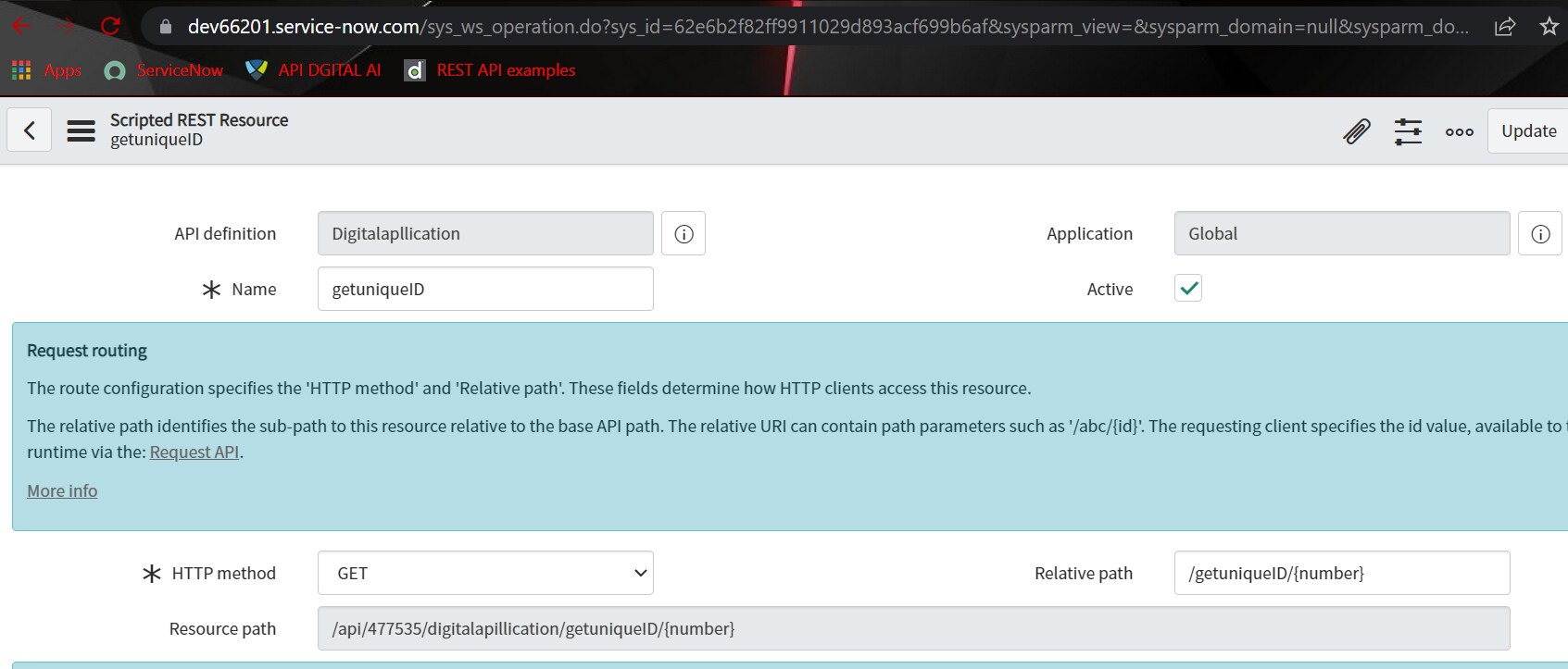

CREATING A SCRIPTED REST API => SCRIPTED REST RESOURCE:
HTTP METHOD :GET
SCRIPTED REST RESOURCE SCRIPT TO SEND THE STATE AND APPROVAL  FIELD VALUES

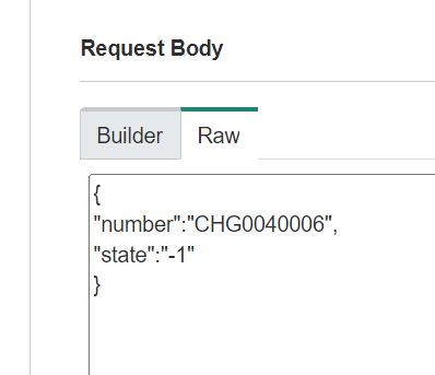

SCENARIO 2:
(TRIRD PARTY APP WILL SEND CHANGE NUMBER AS INPUT
TRIRD PARTY APP WILL CONSUME SERVICENOW API
SERVICENOW SHOULD UPADTE STATUS FIELD VALUE)
METHOD 1:
HTTP METHOD :POST
SCRIPTED REST RESOURCE SCRIPT TO UPDATE THE STATE FIELD:
METHOD 2:(IS THIS METHOD WRIGHT OR WRONG?)
CREATING WEB SERVICES => INBOUND => WEBSERVICES FIELDS
MAPPING WEB SERVICE FIELDS TO TARGET TABLE
note: KEEPING CHANGE NUMBER AS COALESCE
WHEN THIRD PARTY SEND THE CHANGE NUMBER IF CHANGE NUMBER MATCHES IT WILL UPDATE THE CHANGE RECORD.

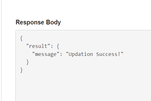

Scripted rest api is a better option because you need to send only couple of fields data and update 1 or 2 fields in ServiceNow. It is easy to use Scripted rest api and you have more control on request body and response body. Using scripted rest api you can create the response body as per your requirement. Also you can show different error message as per your requirement which is easy to understand based on your validation.
You can use Scripted Rest API for your both Scenarios
