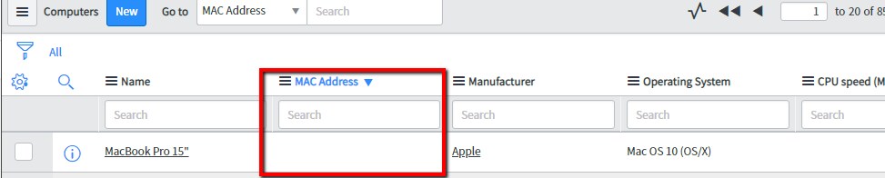

Hello I am finding any filter to get CI's using mac address i have issue in this on computer table the record not showing mac address but after opening record in network adapter tab i see a mac address. i want filter to find CI's using respective network adapters mac addresses.

Maybe it will be repetitive, but on the first screenshot you are looking for MAC address at the cmdb_ci_computer table, on the second screenshot you're looking at different table cmdb_ci_network_adapter. You can populate mac_address field on cmdb_ci_computer table to be able to search and filter by MAC address.
