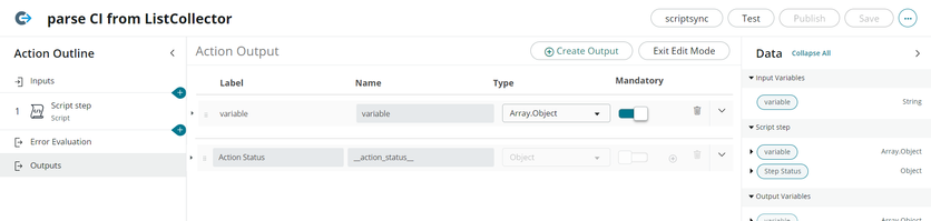

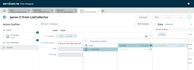

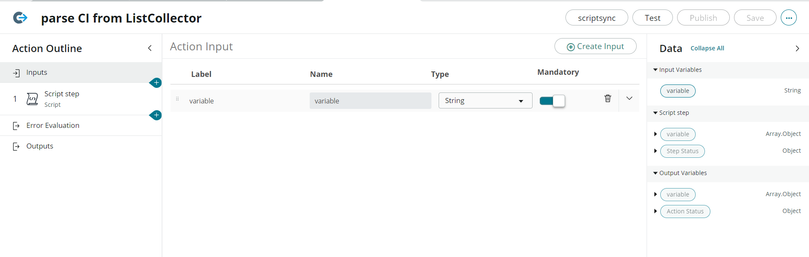

I have an issue with a list collector field value in flow desinger.
Objective :

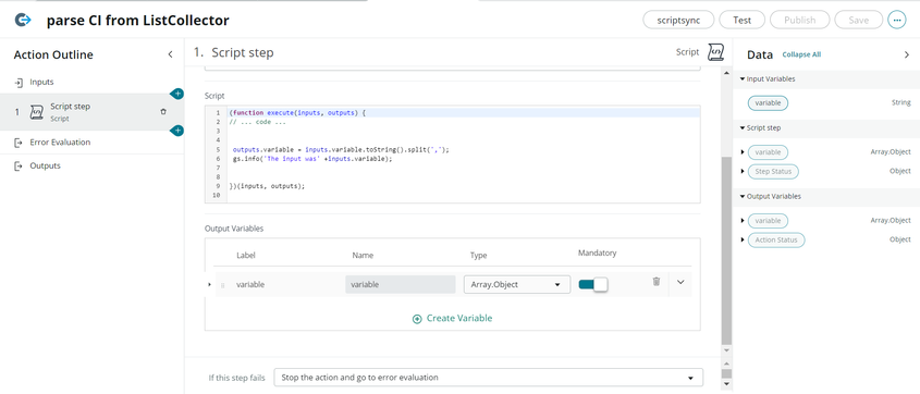

I want to collect the list of CIs in a list collector and use in flow designer to set them as Non-Operational. I tried to create a custom Action and use in flow to parse with split(','). But had no luck. Seems like the issues is with input and output value types such as array.object or array.string.

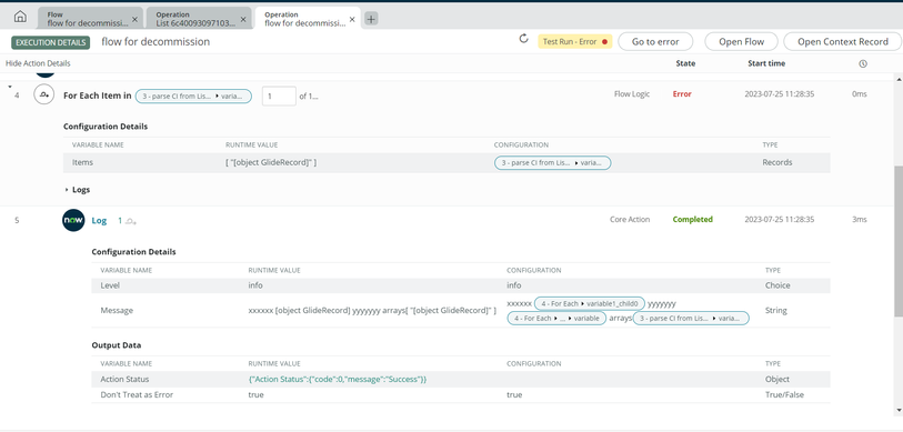

i Tried both but no luck, in flow log i get return value as [Object Glide Record].
Error Log:
INPUT:
SCRIPT :
OUTPUT:
@Ankur Bawiskar , I refered to your article too... can you help in this case?

07-26-2023 02:57 AM - edited 07-26-2023 02:58 AM
Hello @Sohail Khilji ,
In the script step where you are populating the output.variable, instead of adding -
outputs.variable = inputs.variable.toString().split(',');
please replace with the below line -
outputs.variable = JSON.stringify(inputs.variable.toString().split(','));
This will definitely remove the "[object GlideRecord]" output.
Hint: JSON.stringify() takes a JavaScript object and transforms it into a JSON string.
Please mark the answer as correct if it helps!
Ni**bleep**a

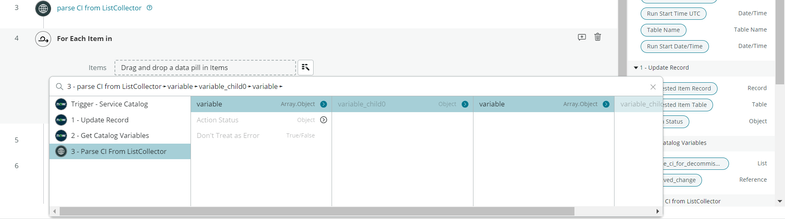

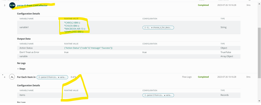

07-26-2023 03:27 AM
@Nishita Padwal , Thanks, That works but,
cant use the output of action in ForEach condition. I tried to log both varaibles but i get runtime value as empty.
Any suggestions ?
