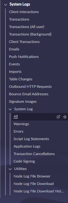

To enable debug logs and check sp_search logging, we attempted to find System Logs → Debugging → Debug Log in our vendor instance. However, we could not locate it. We have also tried accessing it as security-admin, but it’s still not available in the menu.
Attached is a screenshot of the System Logs menu. My version is Washington DC—do you have any insights on why the Debug Log option is missing?
