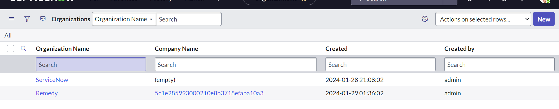

I have a issue with Reference Field in ServiceNow. I go the requirement to create new forms Company and Organization.
In Company i have fields "Company name" and "Status(Active/Inactive)".
In Organization I have fields "Organization Name", "Status(Active/Inactive)" and "Company name(Reference Field)".
Now when i am selecting Company name field in Organization form i can see the list in the pop up list, but when i select the company name. The name is not getting displayed.
Next in List view also same.
Screenshot attached for reference , can someone help me about this issue.
Prakash
Hi @prakash51
Because of created or sys_id column display value is true.
Go to table and make Name field/column display as true.
also share the full screenshot of the both tables created.

Hi @Dr Atul - LNG
I already did this but still getting same in List view . Do you have any idea about the Form view as well?

Hi @prakash51
Manikmodi16
Can you please check if in the Dictionary Entry for the Name field in your Company table, the Display flag is set to True.
