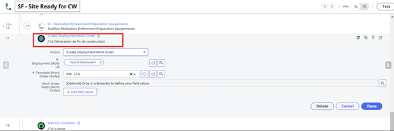

The first capture shows a subflow where the custom step is used to create a work order.

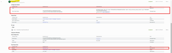

The second capture shows a subflow where the out-of-the-box step is used to create a work order.
The custom step is configured to copy the location from a specific table to the created work order, whereas the out-of-the-box step does not perform this action.

For some records that trigger the flow, instead of using the custom step, they unexpectedly use the out-of-the-box step. This issue occurs only in the subflow shown in the first capture, even though this subflow is explicitly configured to use the custom step (as seen in the capture).

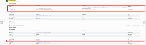

The last capture shows an execution of the subflow that was supposed to use the custom step but instead used the out-of-the-box step, despite being configured otherwise.

As explained, the step defined in the subflow to create the work order is the custom component, as shown in the screenshot below. Therefore, it should not be using the OOB component, which makes this issue quite bizarre.
When this issue occurs (as shown in the screenshot below), the OOB component is unexpectedly executed instead of the custom action, which is incorrect. There is no logic in the flow or subflow that dynamically chooses between the two actions , only the custom action should be used.
The only available information I have to analyze the execution is the screenshot below, which helped me identify that the OOB action was used instead of the custom one.
