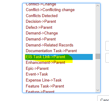

So you have it all in your script.
    var link = new GlideRecord("u_eis_task_link");
    link.initialize();
  link.parent = current.sys_id;
    var changeRequest = new GlideRecord("change_request");
    changeRequest.short_description = current.short_description;
    link.eislinked_task = changeRequest.insert();
    new EISTaskLinkUtils().copyChangeInfoToLink(link, changeRequest);
    link.insert();
In your change request form layout, expand the reference field eislinked_task. The eislinked_task will have a parent field. Move it to the right bucket and you will be able to see the task number.
when I open the change form layout, I see the following:
If I add that to the form, I get the following:
The linked task should be showing up further in the bottom under the page
