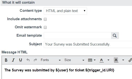

I captured a screenie.. this is how it looks currently. When I recieve the email however, it shows the User, but then says "for ticket ____" and its blank.
It does this using URI, or URI_REF.
I wonder, is there some other area that some scripting needs to be added?
