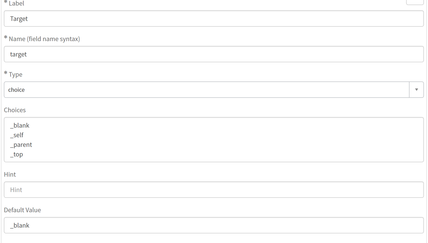

If you look at the HTML code of Icon Link, you see that the 'target' attribute of the a href is defined in data.target field.
line 3 of HTML code of Icon Link widget
<a ng-if="::(options.link_template == 'Circle Icon')" ng-href="{{::data.href}}" class="circle_icon {{::options.class_name}} text-{{::options.color}}" target="{{::data.target}}">
Please, check the widget if you've any option schema with label 'target' since the server populates this field from options.target, which you see on the server side.
Line 4 of Server Script of Icon Link widget,
data.target = options.target || "";
If you don't see an option for target.   Clone the widget and add option schema target with four possible values,
_blank         Opens the linked document in a new window or tab
_self         Opens the linked document in the same frame as it was clicked (this is default)
_parent         Opens the linked document in the parent frame
_top         Opens the linked document in the full body of the window
Note: These are the standard HTML side which specifies where to open the linked document.
Once option schema is added, you can chose one among these values to achieve the behavior you intended.
I hope this helps.
