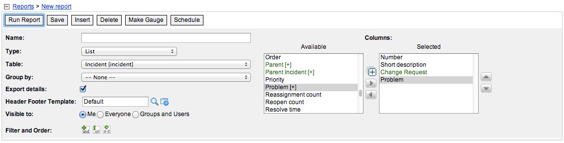

I think you may have misunderstood, screenshots with similar example in's below. What you need to do is replace the dot-walked fields for 'number' with the reference fields themselves, so you have:
and what you need to get to:
Notice how you have used the Change Request.Number and i have just used Change Request. I didn't press the green plus, i just chose the reference field and moved it right to the selected bucket.
Give that a go!

I see that the first field in your list layout is change request number. Normally the first field always points to the table on which we are doing reporting and in this case it is Project Task Link. Move this field to 2nd or 3rd position in the list layout and check.
‎04-30-2014 12:24 AM
Hi Axel, You need to change the first column in your report to just be the 'Linked Task' field without dot-walking to the 'number' column on that table. Because the number column is usually the display column anyway this will not change anything on your report but will fix your issue.
