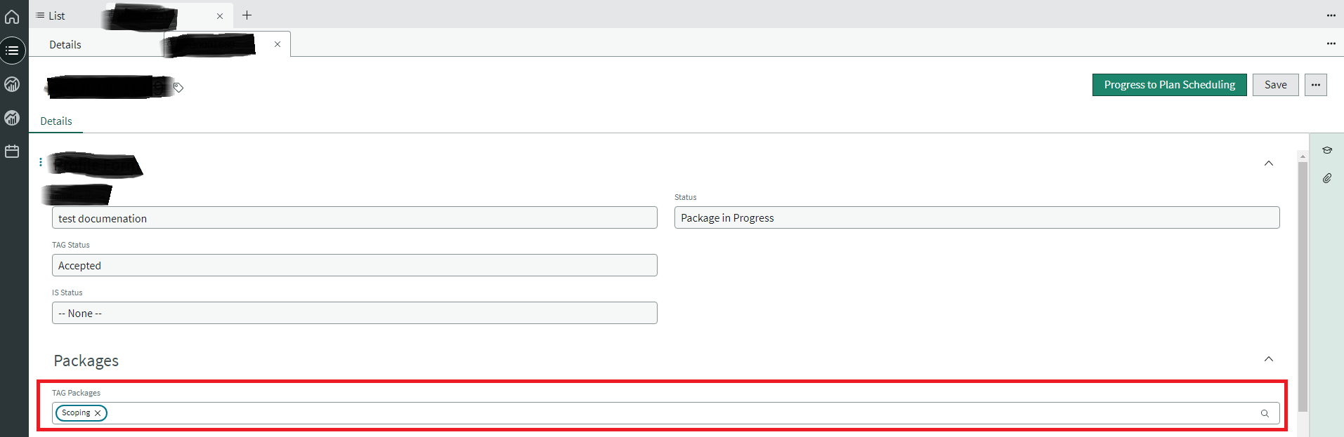

We have created a custom workspace using UI builder and showing records using OOB record page.
We created a custom table and added field with type as LIST (like watch list).
The ‘list’ type field is working as slush bucket in backend (Main UI) and we are able to add multiple values in it.
working as expected in backend (Main UI)
But for same field if we try to select multiple values by clicking on search button in List field and selecting the values is not working. Those values are not getting added in field.
As it in not working as expected. If we try to add more than one value in field then it is showing only the first value which is selected first time.
