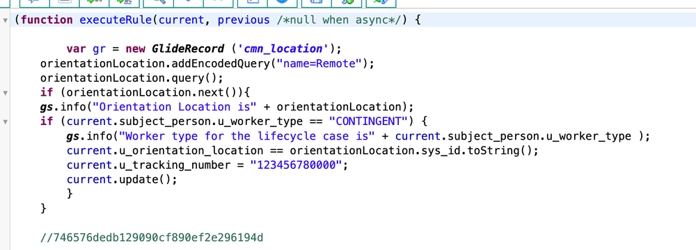

Hi there,
Can anyone help with the code?
I am trying to Orientation Location which is reference field to cmn
_location table.
17 REPLIES 17
Simran321
@Bert_c1 - Thanks for quick respose. It did not work.
Why did you change your GlideRecord variable to gr?
Thanks @Brad Bowman  . Yes accidently updated to gr
If it's still not working, confirm that CONTINGENT (case-sensitive) is really the value stored in your custom worker_type field.
@Brad Bowman  gs.log is populating the sys_id now but it is not populating on the case still.
