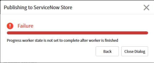

My application appears to be damaged as well. I tried publishing it, it failed with an error. There's an entry on sys_app_list.do but even as an admin and a security_admin, I cannot write or delete. The link to switch to application scope reloads the page but does nothing.

EDIT: When I attempt to publish to "My Repository" so I could load it in test or production:

To add, for reasons that are not clear, my application is now listed as an "External application" -- not sure what this means in the context of an app I created myself, but when I hover over the red warning it says, "Application scope is not from your company. This application cannot be published to your repository or store." -- this issue is "fatal" for me since I need the ability to publish to the company's test & production instances.
This will be because the applications scope prefix does not belong to your customer. When you build an app in a personal dev instance the scope prefix will be something like "x_254103_" whereas an app created in your customers instance would be "x_[their company id]_".

Dan -- thanks for the outstanding response --
Completing the old update set did not fix the problem, but ultimately it doesn't matter, as I need my app to have the correct namespace identifiers as you clearly and helpfully explained.
As things stand, I'm going to call my prototype "water under the bridge" -- it was an essential learning experience in any case -- and start fresh in the customer's dev instance. There were a couple of fundamental design changes I wanted to make anyway that would have been challenging if I used my original code and assets. It puts me a day or two behind, but I'd rather be a day or two behind and do it right than to be a day or two ahead with an unpaid technical debt when I deliver this product.
