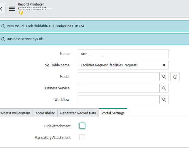

Correct...this is for a record producer, however, the out-of-the-box checkbox you recommend is only for catalog items

Yes, I'm aware it is extended, I just couldn't find the out of the box "mandatory attachment" checkbox...I am assuming it due to my instance version which is London. Also thee script on your article doesn't even let me submit the form...it sort of crashes

I did via DOM Manipulation in an onSubmit catalog client script, it worked but may break in future.
But in Madrid, it seems to have a checkbox for mandatory attachments on catalog item. Once Upgraded to Madrid, need to change the piece of code.
