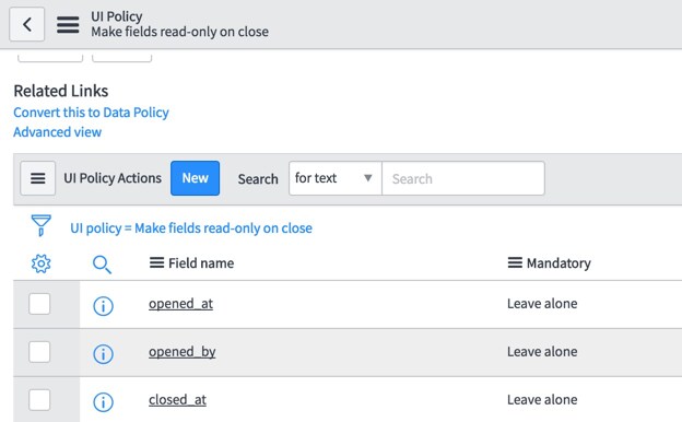

The UI policy actions are a related list at the bottom of the UI policy form. Click New on that related list.
