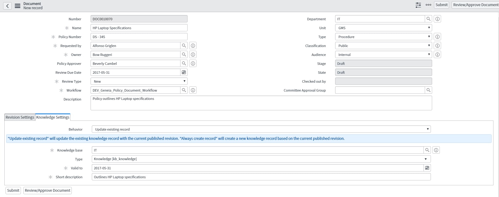

Hello Rajeev,
You are correct the workflow is triggered once but then will not run any subsequent times.   The workflow itself is triggered by a custom field "State" on the document table.   The default value of this field when the document is created is "Draft" but when the custom UI Action button is clicked the "State" field is changed to "Awaiting Review".   Once this change is made the test workflow which is associated to the Document table is kicked off.   I can verify this by going to the active workflow contexts and also by a related list which I built into the document form, see below for screenshots:
Creating a new document:
Document is created and showing in the MD application:
Document detail:
Clicking the "Review/Approve Document" button will change the State from Draft to Awaiting Review, see the code behind the button below:
