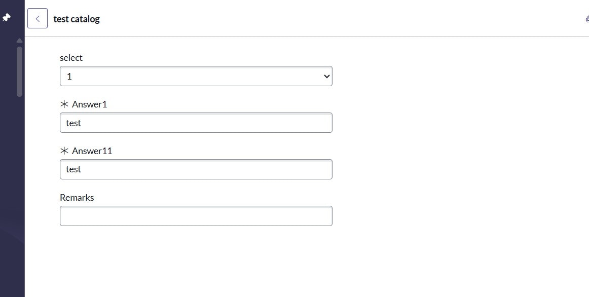

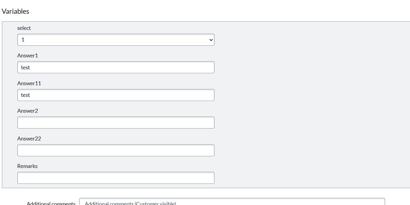

HI @J Siva This method is not working i have tried when i apply all this conditions isn't behave correctly kindly suggest i have mentioned on change script so kindly review it and propose solution .this on change script not working in task view also   i have selected all the view form  option. and global icon also checked
if i select 0 to 1 and 1 to 2 its working fine when i select 2 to none functions not working .
