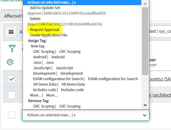

‎02-03-2022 04:09 AM
Hi Rohila,
Thanks for getting back to me!
I had to activate the UI action but I see the 'Request Approval' option now! 🙂
What I'm now getting stuck at, is it is not sending an approval email notification to the user, assuming as this is in the workflow.
Do you have this set up/can advise on how to achieve this?
I read an option is to create a business rule on approval table, trigger an event, send notification but I'm sure where to begin with all that!
Alex
‎02-03-2022 04:41 AM
Hi Again,
I managed to trigger the approval emails from the RITM record when clicking 'Request Approval'.
I achieved this by adding the line below to the UI action script -
gs.eventQueue('approval.inserted', current);
However, it is sending 2 of the exact same emails and I cannot figure out why, any ideas?
Thanks again,
Alex
