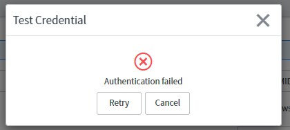

Even after checking about three point, AD connection is not working. Do I need to check any additional details, like any specific port that needs to be open to connect to microsoft AD.
By default system takes 135 Port,does it mean, I need to open PORT 135 on the midserver to connect the target host AD server.
I am getting "authentication error". Kindly help

Did the AD domain validate the credential works?

Test connection will fail with Authentication failed error, but you can still proceed and test credentials by running flow action (e.g. Add User to Group ) it will work.
KirilD
actually the Test credential most probably is using some workflow, which fails, that does not mean your credential is not properly configured. You can always check with AD team if your credential is valid. Try the connection test from the Credential Store.
