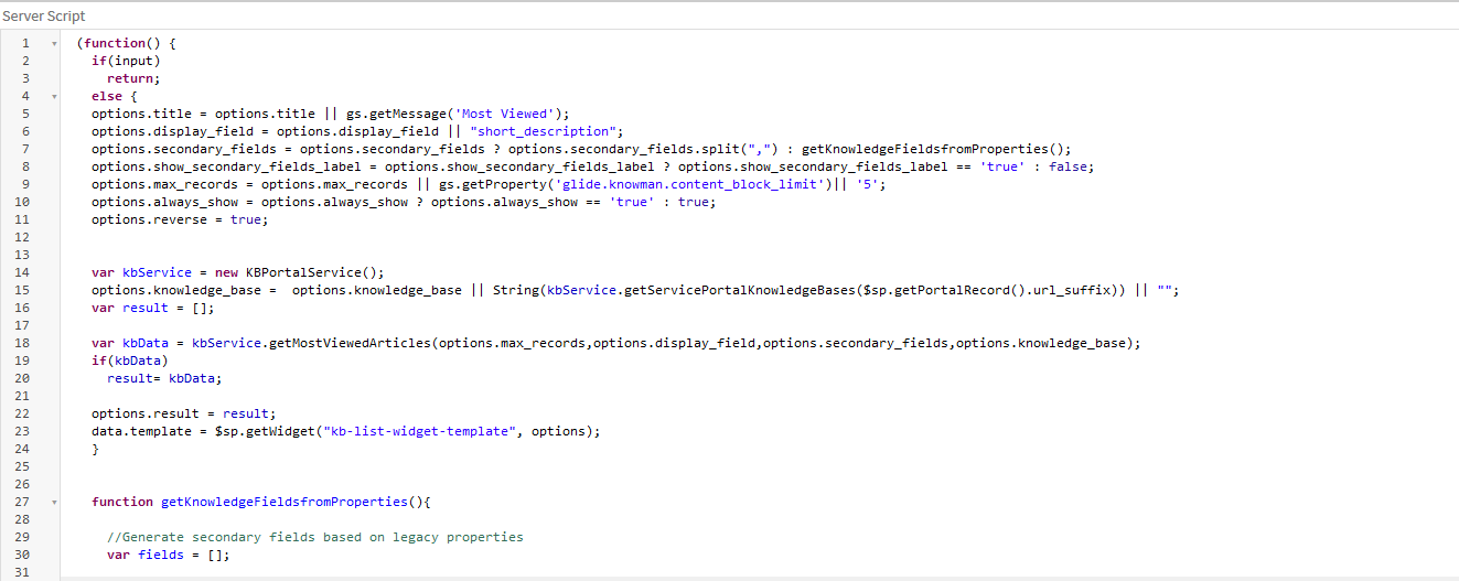

I'm building out our new Service Portal and want to display the most viewed knowledge articles using the "Most Viewed Articles" widget. It is working as intended but there is a knowledge article that is our most viewed but my customer doesn't want it displayed in the widget as the most viewed article for various reasons. I tried setting the view count back to 0 so it doesn't display and it works but the system resets it back to its previous number every night, making it the most viewed knowledge article again. Is there a way to script that knowledge article out from showing up in the widget or keep the view count at 0?

Just add a query in your widget to exclude KB articles after z.addQuery("kb_category", options.kb_category); in server script.
Query will be something like : z.addQuery('number','!=','KBXXXXXX');
Hi rajneeshbaranwal,

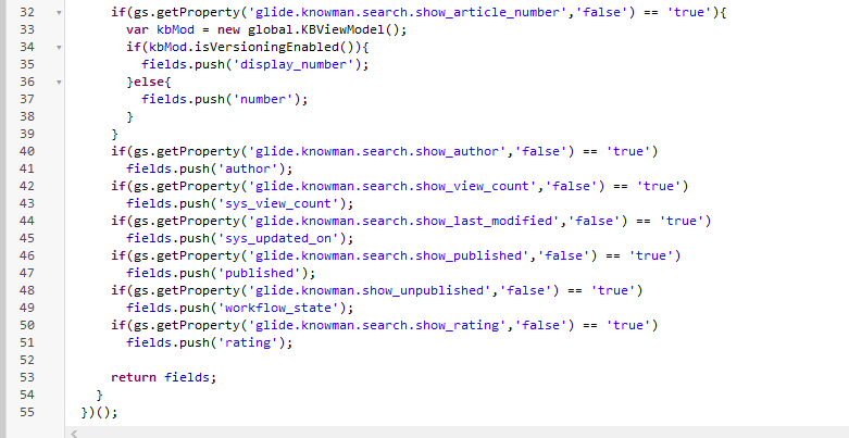

Thanks for responding! My server script for that widget looks different from yours. Here's what mine has:
Can you show me your HTML section ? In HTML section you may add ng-if that if result.number is not KB number.
