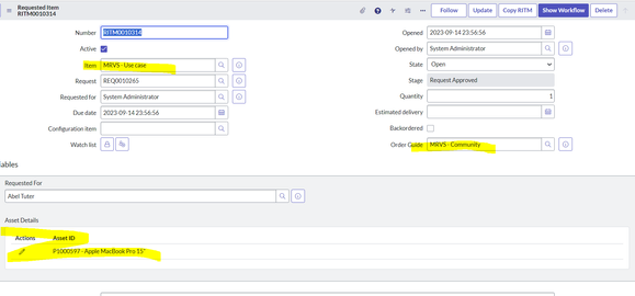

Hi @S Diener
Got your point , I have checked in my PDI & for me MRVS is populating data if it submitted through Order guide as well.
