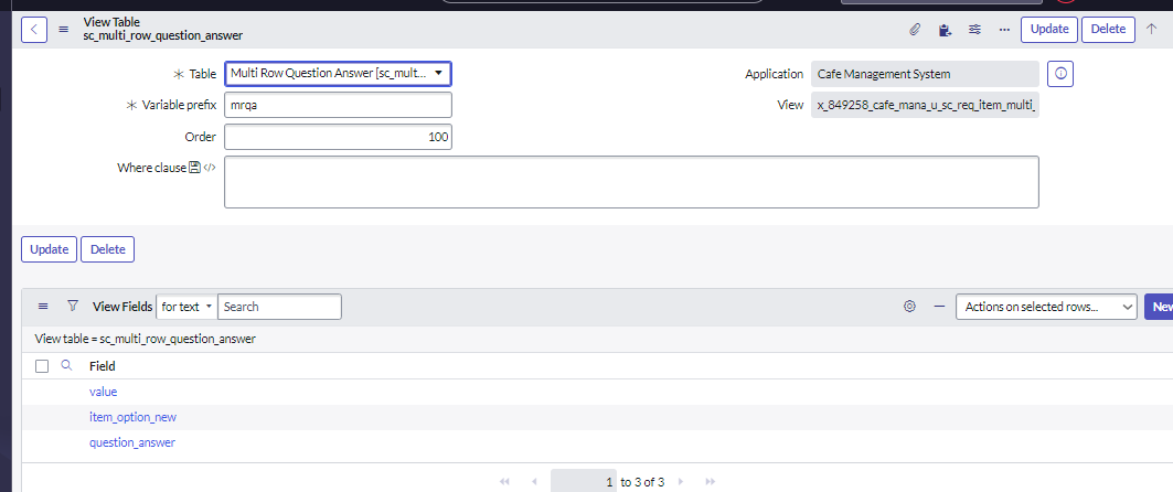

I see, may I ask for help regarding setting it up if I did it correctly if its alright? I am very sorry as I am still new to SNow.
This is my current database view.
The table for drinks:
the u_name_1 refers to this specific field in the Drinks table
The table for sc_multi_row: (I have a question, since I only needed for it to show the proper value as you have mentioned, how may I set up the fields for this table in the database view?
08-15-2022 03:15 AM
For MRVS table, bring "value" field as well in view fields
For your drinks table, bring sys_id and name field.
Now for joining the tables use:
mrqa_value = sci_sys_id
