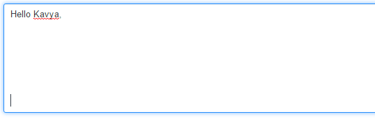

I have created one record producer where i have used type of one variable as   multi line text. when i am seeing it via analyst portal then it works fine(it means when user is writing 100   lines of code then user can see entire details at one time.
But when same record producer is displaying on service portal and i am pressing enter then at one time entire details is not visible though there is a icon highlighted in yellow color by which we can expand it and can see all information.
But my requirement is on service portal, area of this variable   somehow should be large by default when anyone open it.
My question is can we achieve it via using widget which comes on while declaring variable type on record producer.? if yes, then how?

Yes record producers are displayed using the "SC Catalog Item" widget. You can clone this and do your modifications, and then replace it on the "sc_cat_item" page.
You can however also just add the CSS to the entire page - then you don't have to modify the widget

We have solved the same issue by adjusting the css in the widget.
Add the following to your record producer widgets css;
textarea {
  height: 10em;
