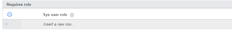

We are trying to change the permissions for the knowledge base so that ITIL users can Create and Edit draft KBs only. We are using the following 2 rules to do this:
1. Restrict write (this should grant the 3 roles listed access to write everything and prevent ITIL from doing the same)
Type: record
Operation: write
Requires Roles: itil_admin, knowledge_manager, knowledge_admin
Condition: NONE
2. Allow ITIL users to edit Draft KBs
Type: record
Operation: write
Condition: Workflow is Draft
The problem I am having is if the user has a role form each role. I want a user with both the knowledge_admin and itil roles to be able to edit a KB in all workflow states but it is not working. Users with knowledge_admin and itil are getting treated like an itil user in that they are not able to edit non-draft KBs.
Also is there a way to make the Workflow field read only for ITIL while using the above rules? I would rather not create a version of rule # 2 for each field on the form excelp workflow.
Thanks!

Gupreet,
I used a script in a single rule but it is not behaving as expected.
The rule above is evaluating to false when it looks like it should be true. See below, I am aliased as a User with the 'itil' role.
Here is the evaluation of my rule, looks like the above script is evaluating to false even though the state is draft and the user has an 'itil' role.
The script is evaluating correctly for users with the 'knowledge_admin' role.
Any ideas?
EDIT: I figured it out.
In order to reference a field on the object that the ACL applies to you need current.[fieldname] so current.workflow_state == 'draft'. This is now working for me.
