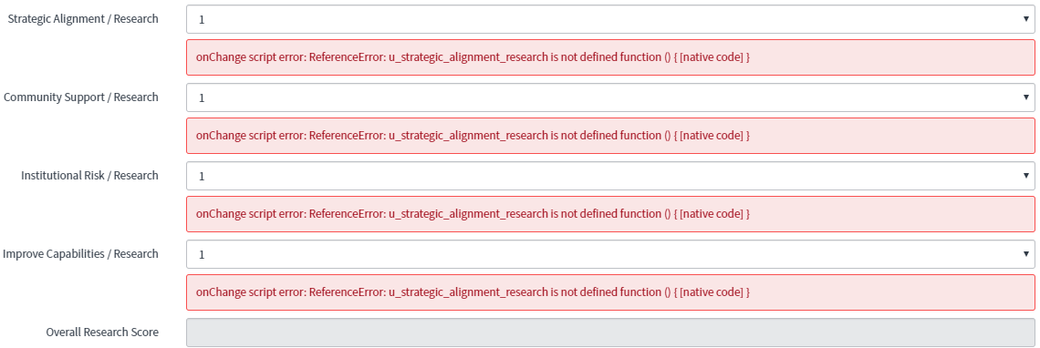

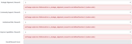

Hi Akash,
So i created onChange client scripts for each of the following fields like you recommended: Strategic alignment, Community support, Institutional risk, Improve capabilities.
I also created an onLoad script with the same code. When i load the page i'm getting errors on each of the fields. Sorry i'm not coder so maybe I misinterpreted something in the code.
Hi Raul,
I see a mistake in the var researchScore part of the code. You should be using the declared variables in the parseInt() function.
Please replace it with the following
var researchScore = parseInt(strategicAlignment) + parseInt(communitySupport) + parseInt(institutionalRisk) + parseInt(improveCapabilities);
Hope that solves the problem.
