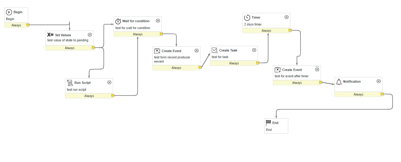

In workflow, there is a "wait for condition" activity which receives the two in arrows. After that all activities are triggering twice, and there is a "create event" activity in between which triggers notification. the notification has to be sent only once to the user which is going twice instead. i have verified the business rules to see if it is triggering the event which intern triggers additional notification, but there is no business rules which triggers the event.please help me on this.

this actually seems logical to me. You have created two paths that both lead up to the 'Wait for condition' and then to 'Create Event', and therefor both paths do trigger the event. The 'Wait for condition' itself does not check if it has already been triggered by another path, it will just fire.
To avoid this kind of behavior, either remove the path between 'Run Script' and 'Wait for condition'. Another thought would be to just have the first three steps in serial (i.e. why are you branching between 'Run Script' and 'Wait for condition'?).
Or, add a variable to your workflow that is set to 'True' by 'Create Event', and have 'Create Event' check if the variable is 'False' before actually firing the event.

This is my current workflow,

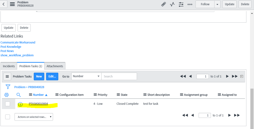

1.Accordingly after "create event: test form record producer eevent" activity is triggered twice with different sys_id s, the "create task" activity is also triggered twice but there is only one task created. If that is the case it should create two tasks. please provide clarification on the same.

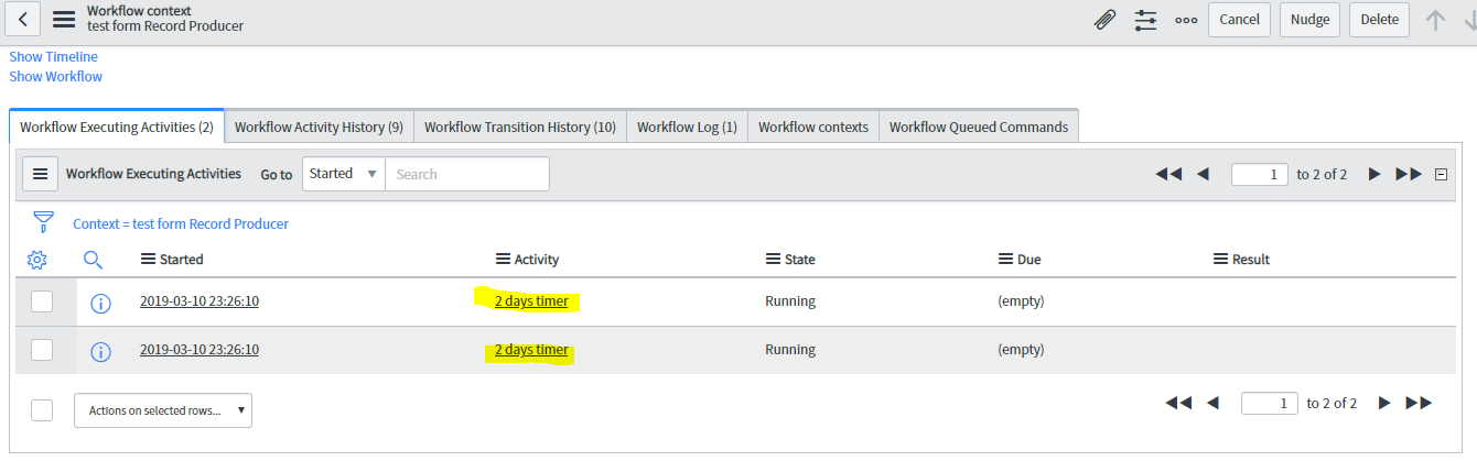

2.There is two timer activity triggered with different sys_id s.After Killing one "Timer", if I try to kill other timer, it shows record not found, though it has different sys_id s. And it triggers the "create event :test for event after timer" activity twice.
