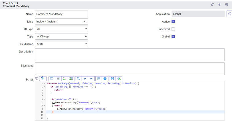

On the incident form, I have the additional comments set to mandatory when the state is on hold (through UI policy). The problem is that the comments field stays mandatory while on hold, even when I just want to update the category field for example.
So I was thinking to use a change operator in the UI Policy so comments are only mandatory when the state changes to on hold, and not while it is on hold. The thing is, there is no change operator in UI policy.

Hi @JordyZ
Please try below Client Script:
      return;
	if(newValue=='3') {
	g_form.setMandatory('comments',true);
	} else {
		g_form.setMandatory('comments',false);
Please mark this as correct answer and helpful if it resolved, or mark this helpful if this help you to reach towards solution.

This did the job, thank you!

surbhi9
You can write an onChnage client script on State field.
  if (g_form.getValue('state') == '3') {
        g_form.setMandatory('comments', true);
Please mark Helpful/Correct, if helped.
