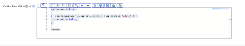

we want that only the Group owner can see and use the "edit" button on the related list "Group Members". Therefore we edited the List control and added following omit edit button script.
But some reasons it's not working, can anyone please help us here.

@LaraReddy, try creating Write ACL on sys_user_grmember group table,
if(current.group.manager==gs.getUserID() || gs.hasRole('admin'){
02-22-2024 05:33 AM

02-22-2024 05:13 AM
Can you try this? It's the edit button on the sys_user_grmember table. That table has no 'parent'. It could also be you need a current in there, but it should help.
var answer = true;
var user = gs.getUserID();
if(group.parent.manager == user || gs.hasRole('admin')){
answer = false;
return answer;
Mark
