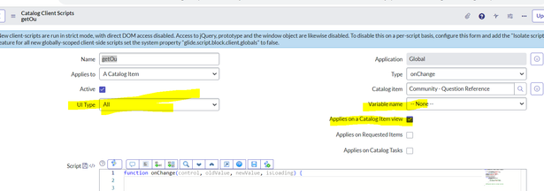

I tried using 'OnChange' Catalog Client Script but it isn't working:::

Can you check if Ui type is selected ALL & Variable name
