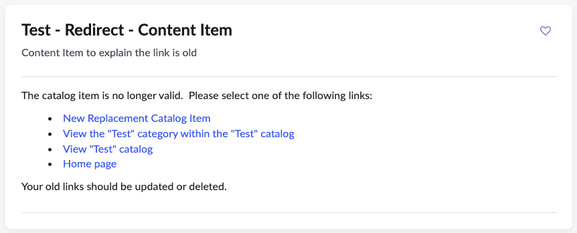

I setup an example scenario in my PDI like this:
1. A Catalog Item that needs to be "retired" or re-directed from:
2. I created a Variable Set that only includes a new "onLoad" Catalog Client Script. That script is configured to re-direct to a Content Item that presents a list of options to users. The UI Type is set to "All" and the script is:
function onLoad() {
//re-direct to the "Test - Redirect Old Item to Content Item" Content Item
top.window.location = "?id=sc_cat_item&sys_id=329c9dc69333311005db7b732bba105e";
}Tip: NOT specifying the "sp" at the beginning of the URL will ensure the user will go to the page I want but remain in the same portal they are already in. You may or may not want that.
3. With the Variable Set added to the old Catalog Item, when a user now goes to it, they will be automatically re-directed to the Content Item I've created with the sys_id in the URL above:
The reason I created the Catalog Client Script within a Variable Set is because you might end up having a number of old Catalog Items you want to re-direct your user from. This way you can just add the Variable Set to those items.
And obviously the URL in the Catalog Client Script can point to anywhere. I created the Content Item as an example solution for the other question.
