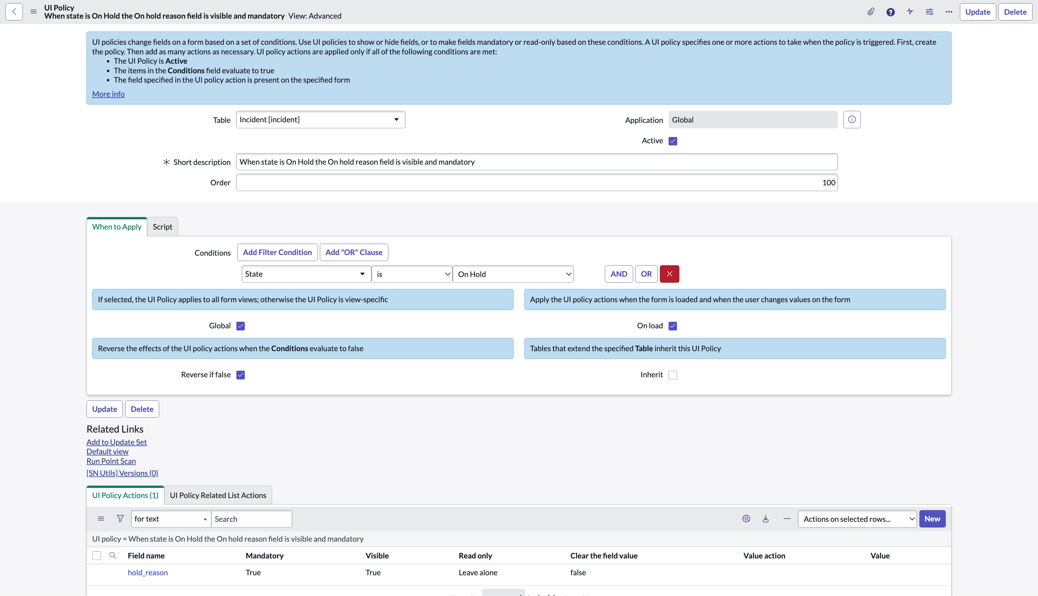

I’m encountering an issue with the OOTB UI policy "When state is On Hold, the On Hold reason field is visible and mandatory" in Service Operations Workspace.
After setting the state to "On Hold," the "On Hold reason" field only becomes visible and mandatory after the record is saved.
This also happens with UI policies I’ve created, where the UI Policy Actions only take effect after the record is saved, making the required fields mandatory — which isn't the expected behavior.

Can you please share a screenshot of your UI Policy record? Make sure you are in Advanced view. I am guessing there is a config that is preventing this from appearing.
Sure, here are the screenshots of the UI Policy and the SOW
