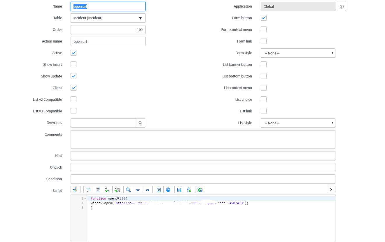

Hi there, I am trying to create a UI Action button in the platform which will open a URL, but it isn't working
here is a pic of the UI I created ( i delete the URL from it):
Can you tell me please what is the problem here?

set "Isolate script" field as false on your ui action

Screenshot for reference.
if field is not available you can add it on form.

also define openURL() in onClick field

Add 'openUrl()' function to the onClick field.
