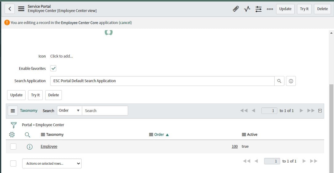

Hi, this is pretty late but I also ran into this just going through the Employee Center Academy: Migrating from Service Portal to Employee Center video.
The presenter clones the existing taxonomy, goes to the portal config page and uses an Edit button to change the taxonomy to the new one. My PDI is on Tokoyo and doesn't display that edit button. What I did was the following:
edit - just switch your application scope to Employee Center Core and the edit button should appear
‎02-28-2023 07:57 AM
Thank you for sharing. I was wondering where the Edit button was. The specs in the docs only says 'Associate the taxonomy to the portal that is created.' but does not mention anything about the need of switching the application scope.
