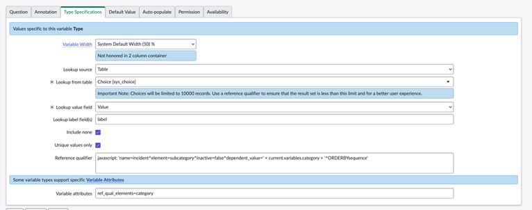

This is working for me.  In a more out of box example I have 2 Lookup Select Box variables on an incident record producer for Category and Subcategory.  This is what Subcategory looks like:
The choices are ordered by the Sequence on the sys_chocie table.  If I take out the orderby, they are sorted alphabetically.  Make sure you have the Variable attribute pointing back to the name of the dependent variable.
