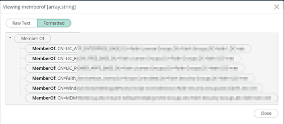

I'm passing the Member Of output data pill from the AD look up to the "Convert array.string to string" action.
This is what my test flow looks like.
That Member Of data pill shows the following output in the operation execution logs.
The formatted view of that output looks like this.
