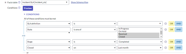

04-20-2023 08:53 AM
Hi @prash4 ,
This is how I would create the indicator source for both indicators (You can off course add additional filters if needed):
(Remember to put in the correct SLA in SLA definition is). by this you will only capture the correct SLA.
Afterwards you create two indicators where one of them have an additional condition.:
Above filter will ensure that indicator only captures the SLA where the SLA hasn't been breached, where the other will capture all - no matter breach or not.
Based on the two indicators, you can now do your calculation in a formula indicator.
