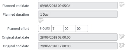

To add to the mystery, the Planned Effort tables looks like this:
But is configured the same way.
Any ideas?
andrewbettc
Also, why is the field decoration for the roll_up calc on the next line when, for all other fields that has the same attribute, it's in line:
