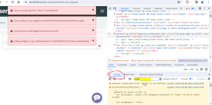

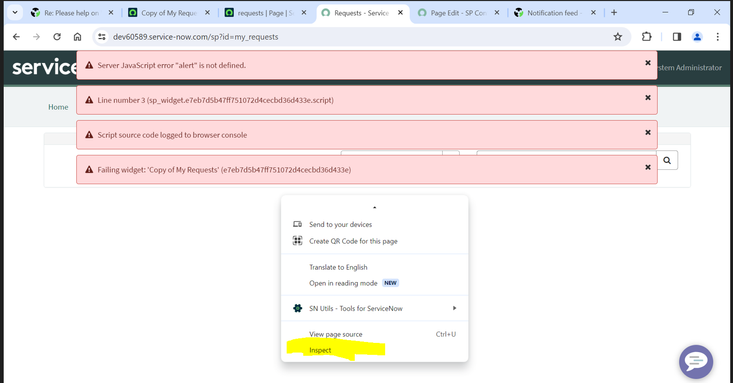

Can you right-click on form in browser where you are getting this error & click on 'Inspect' and check in console log for the script having 'alert' :
here I have just reproduced this error in my portal...for you it will be page editor
Go to console & search of 'alert' word
here you will get to know from which script you are getting error

Hello @Lisa Goldman
You need to find out it in platform in which script/widget script that alert has been added and comment that line or remove it from script.
**If you expand the error in browser console you might get the sys_id of the object in which that alert has been added.
Hope this helps...!!!
