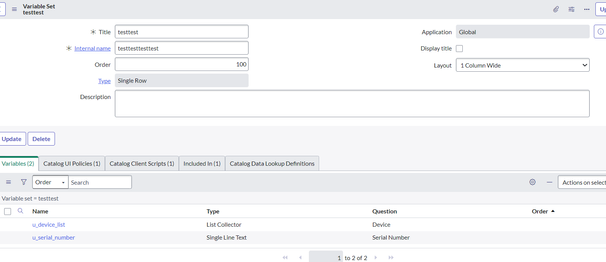

Process description: In the personal developer instance inside (any) Catalog Item a new Variable set is created with the following variables:
  • Device / "u_device_list"  (List Collector)
  • Serial Number / "u_serial_number" (Single Line Text)
Serial Number can be auto-populated using new Vancouver feature "Auto Populate" only if based on the Reference type fields, but not on the ListCollector type. For this case can be used Catalog Client Script + Script Include with GlideAjax (as GlideRecord in Client Scripts is not recommended by the best practices, as it slows down the instance performance).
Solution:
Variable Set:

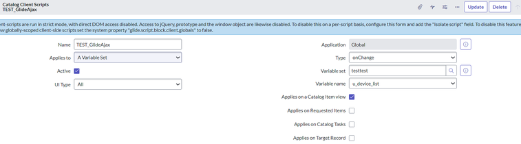

Catalog Client Script:
        return;
    function showSerialNumbers(response) {
        g_form.setValue('u_serial_number', answer);
    var AllCurrentSelectedDevices = g_form.getValue('u_device_list');
    var ga = new GlideAjax('pdi_test_ScriptInclude');
    ga.addParam('sysparm_name', 'TestFunction');
    ga.addParam('sysparm_currentdevices', AllCurrentSelectedDevices);
    ga.getXML(showSerialNumbers);

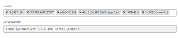

Service Portal view:

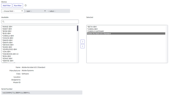

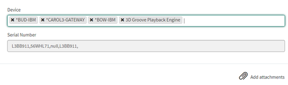

P.S.: When the selected device (any record from the cmdb_ci table) has empty serial number field, Script Include returns "null"; The result will always have "," in the end; In what order the serial numbers will be displayed in the u_serial_number field is out of control.
