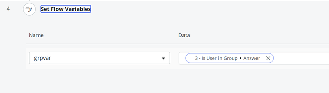

07-30-2024 01:09 AM
So I've tried setting a flow variable and adding the answer to step 3 to that variable then trying to add that to the work notes of the incident, but that didn't work either:
Is this what you meant by setting the flow variable?

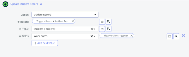

07-30-2024 01:46 AM
This is now working so I had to set the variable as true/false:
Then use the set flow variable:
Than add that to the work notes
Thanks for your helps on this issue 👍
