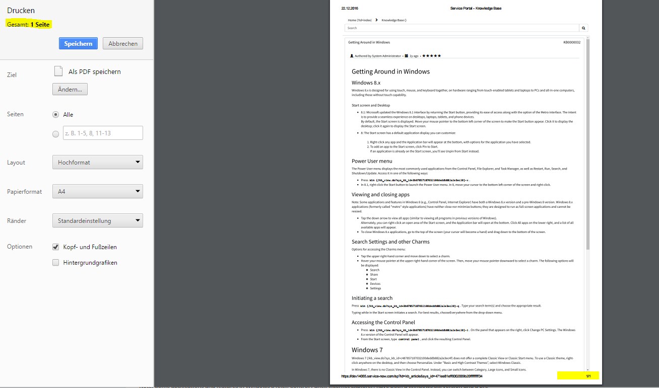

To whom it may concern: when you printing your KB articles in Service Portal you'll face the problem, that only first page is shown in print preview and is printed. Our customers are using the browser printing capability (Ctrl+P).
Caption: Only first page is printed, all following pages are simply skipped
