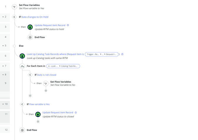

hi @Abbottronix ,
Using flow would be better & future proof.
You can adjust the flow logic as per your requirement.

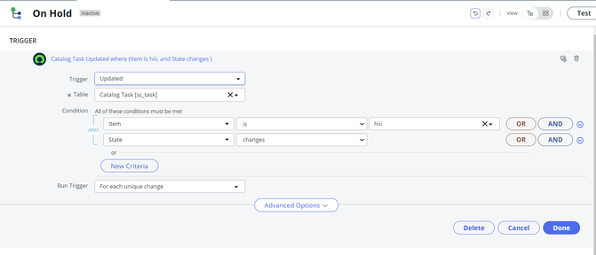

Here I am triggering the flow when Task state is changed. After I am checking if task status got changed to On Hold. If yes, Updating RITM status to Hold. Else using lookup records to get all tasks created under that RITM & checking status of each of of the task & updating ritm to closed using flow variable.
Please let me know if you encounter any issues or need any help.
