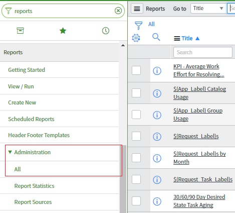

Do you have admin access? On the left navigation you should traverse to Reports -> All module as highlighted

Thanks Alikutty, I was able to 'show xml' it shows the metadata but can't find any 'filter' or the table name mentioned.   I'm doing this on cmdb_rel_ci table. btw, I have admin access. After you said, I have gone ahead and added explicitly the 'report_admin' role.
This is a sort of workaround, If you think the length of Filter column is too short on the list layout, You can remove all other columns except Titleand filter
Or else if the encoded query is too long then you can open a report and right click on header to Show XML and then copy the filter.
