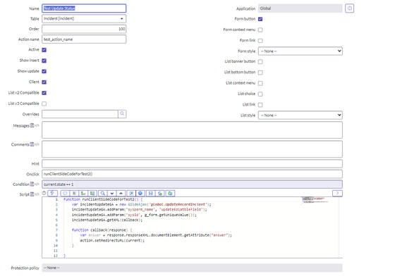

I have an issue displaying the info message "Action not Authorized" when clicking an UI Action and this UI Action calls a sub-flow. In the sub-flow there is update the value of the field "State". If the condition of UI Action check field "State", it will get an "Action not Authorized" error.

My UI Action configure:

 @Dinh Nguyen  I found the root cause. The issue is really your condition. That's why:
  • A client UI Action is called 2 times when using gsftSubmit and each time the condition is evaluated.
You have now three options:
  1. Make this UI Action to a Server side UI Action (client false, no use of gsftSubmit, Script Include not Client Callable)
  2. Don't set State in your flow you can do this finally within your function  runServerSideCode within UI Action with current.state = 2;
  3. Remove gsftSubmit and all from line 14 following. Replace Line 9 with action.setRedirectUrl(current); See screenshot:

Change the condition as below and retry -
current.state == 1

Hi @vermaamit16 ,
I tried but it still shows "Action not Authorized". I think the problem lies in the State field at the same time updating in Flow Designer and Condition of the UI Action executing.
