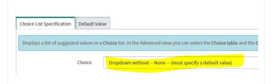

try
or use client scritp to hide using g_form.removeOption();

dont you see an option called ''include none''  in type specification tab ?
