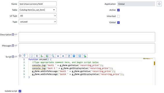

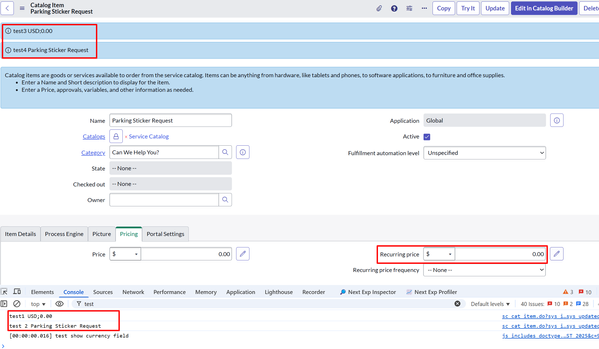

Can you please share a screenshot of your entire client script record? I am beginning to believe it is an issue with this. Could it be an issue with your Application scope being different
I was able to accomplish what you are trying. Also I'd like to quickly note that currency fields return with the currency type prior to the number, as you will see in the screenshot below, which may require you to do some additional scripting if you're trying to extract just the number.
Here is the client script I am using:
