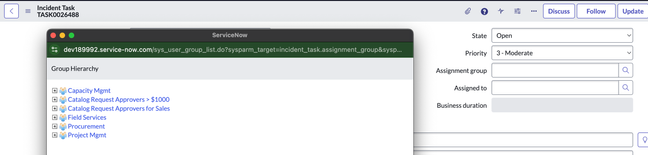

That's helpful.  I meant to ask for these results too, but if you could also show a list view of the table containing the columns Name Type and Parent, with the filter that should clarify things

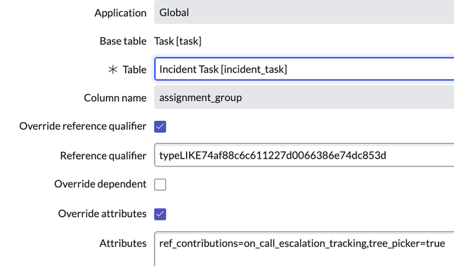

If you change the attribute in the override to tree_picker=false you will see a similar list view, with whatever columns you define in the List Layout - if this view is clearer for you, and you don't need or want to see the group members

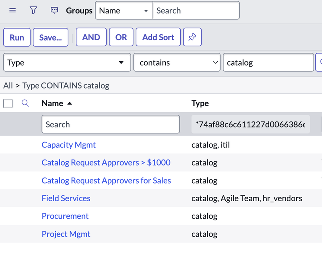

The Type field on the Groups table is a List, which means it can contain more than one value.  Your reference qualifier is only returning the groups which only have that Type, whereas your list filter is including groups that have that Type as one of the values.  To include the others in the reference qualifier, change the beginning to
typeLIKE
followed by the sys_id of the type you are after.

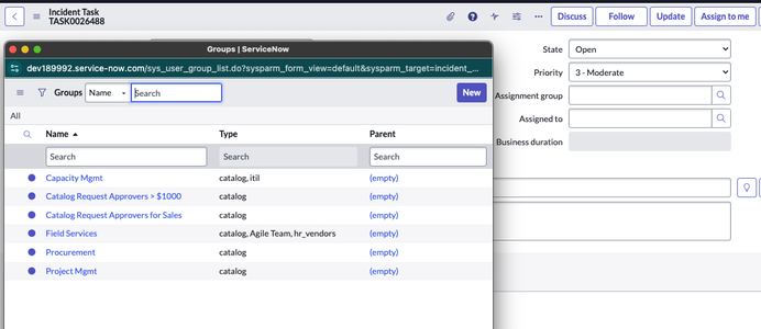

This is not making sense, but I'm sure there's a perfectly logical explanation.  Let's break it down to clarify assumptions and see where it's going wrong.  I have a sys_user_group_type record - let's say it's the out of the box one named 'catalog' with a sys_id = 74af88c6c611227d0066386e74dc853d
If look at a list view of the sys_user_group table, then manually filter like this, I see 6 records in my instance
I create a Dictionary Entry Override for the assignment_group field on the incident_task table using the Attributes you have, and a reference qualifier like this:
On an Incident Task record, when I click the reference search icon (magnifying glass), I see the expected 6 group names
