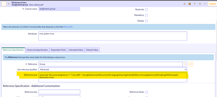

Approach 1: Using Reference Qualifier Only
- Please find the below reference qualifier code:
javascript: if(current.assigned_to !="")'sys_idIN' + new global.ArrayUtil().convertArray(gs.getUser().getUserByID(current.assigned_to.toString()).getMyGroups()); else'active=true';
- Note: While it's often mentioned that using if-else conditions in reference qualifiers might not be considered best practice, I've personally found it effective in many cases. Additionally, I came across an article that also supports this approach. So, feel free to utilize it as needed.

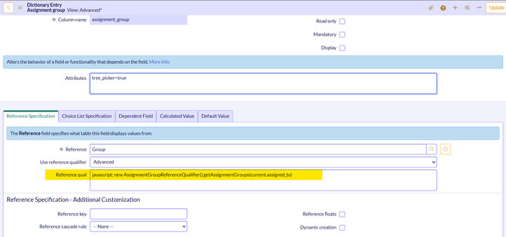

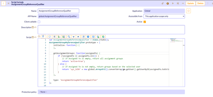

Approach 2: Using Script Include and Reference Qualifier
- Alternatively, if you prefer to avoid if-else conditions in reference qualifiers, you can utilize a script include. I've created a script include named AssignmentGroupReferenceQualifier with the following code:
var AssignmentGroupReferenceQualifier = Class.create();
AssignmentGroupReferenceQualifier.prototype = {
initialize: function() {
getAssignmentGroups: function(assignedTo) {
if (!assignedTo || assignedTo.nil()) {
// If Assigned To is empty, return all assignment groups
return 'active=true';
} else {
// If Assigned To is not empty, return groups based on the selected user
return 'sys_idIN' + new global.ArrayUtil().convertArray(gs.getUser().getUserByID(assignedTo.toString()).getMyGroups());
type: 'AssignmentGroupReferenceQualifier'
- To use this script include in your reference qualifier, use the following code:
javascript: new AssignmentGroupReferenceQualifier().getAssignmentGroups(current.assigned_to)
