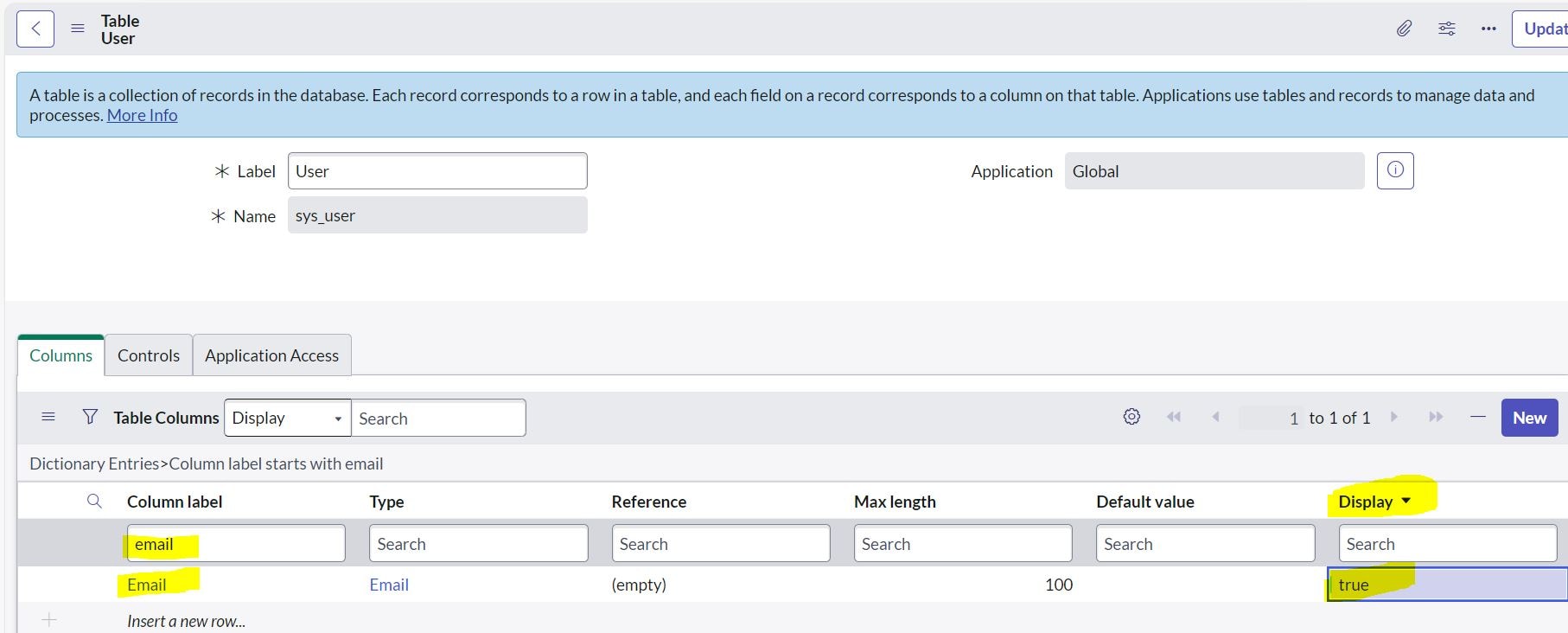

You need to go to the user table and for email field you need to set the display as true but this will be global impact. It will impact everywhere in the instance.
https://InstanceName.service-now.com/sys_db_object.do?sys_id=sys_user&sysparm_refkey=name
In above link change the instance name. and under column related list search for email and set the display as true(check attached screenshot for more clarity).
