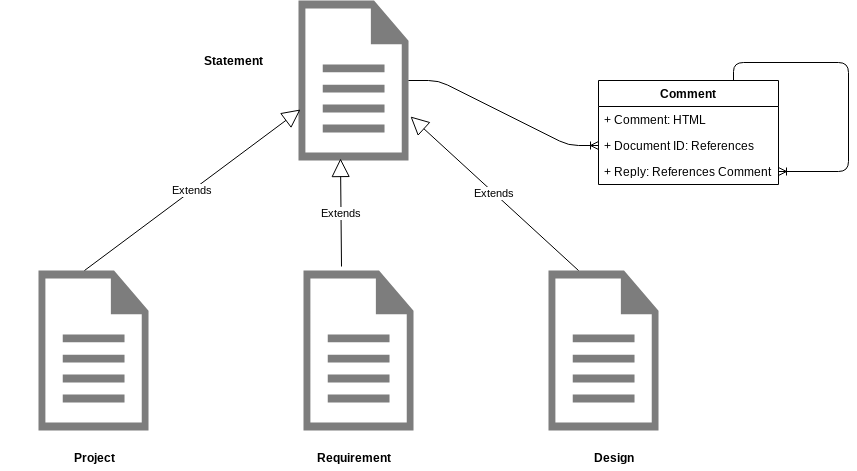

I have a generic table "statement" that I then extend into several tables, each with some specific attributes. For example "Requirement" statements and "Design" statements.
Each statement type has its own form for entering data and from each form I want the ability to click a button to create a comment record to allow the user to record an opinion of the statement. The Comment record contains a reference back to the parent statement.
Because each table extends statement, and all the individual statements from the derived tables are available in the table "statement" I thought I could reference statement from my comments table. Then I could create a comment on a Requirement statement and it would reference the parent in the Statement table. I could also create a comment on a Design statement and it too would reference the parent in the Statement table. But this doesn't work.
It only works if I have an individual Comment table for each Statement table
This is a diagram of what I was hoping to achieve:
